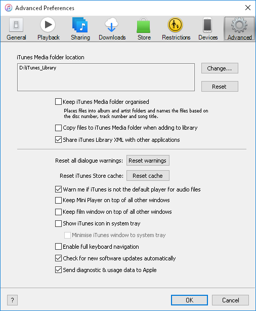

After an update of iTunes, I can now longer browse in the iTunes music library from my DJ software (VirtualDJ, Djuced, Traktor, Serato).
Product number : 4780583
4781018
4782002
Close your DJ software
Make sure you have the option of iTunes to share your iTunes library XML with other applications is still activated :
If it does not work, then re-install the DJ software.
- Run iTunes > Go in Preferences > Go on advanced tab >
- Check the field "Share iTunes iTunes Library XML with Other Applications">
