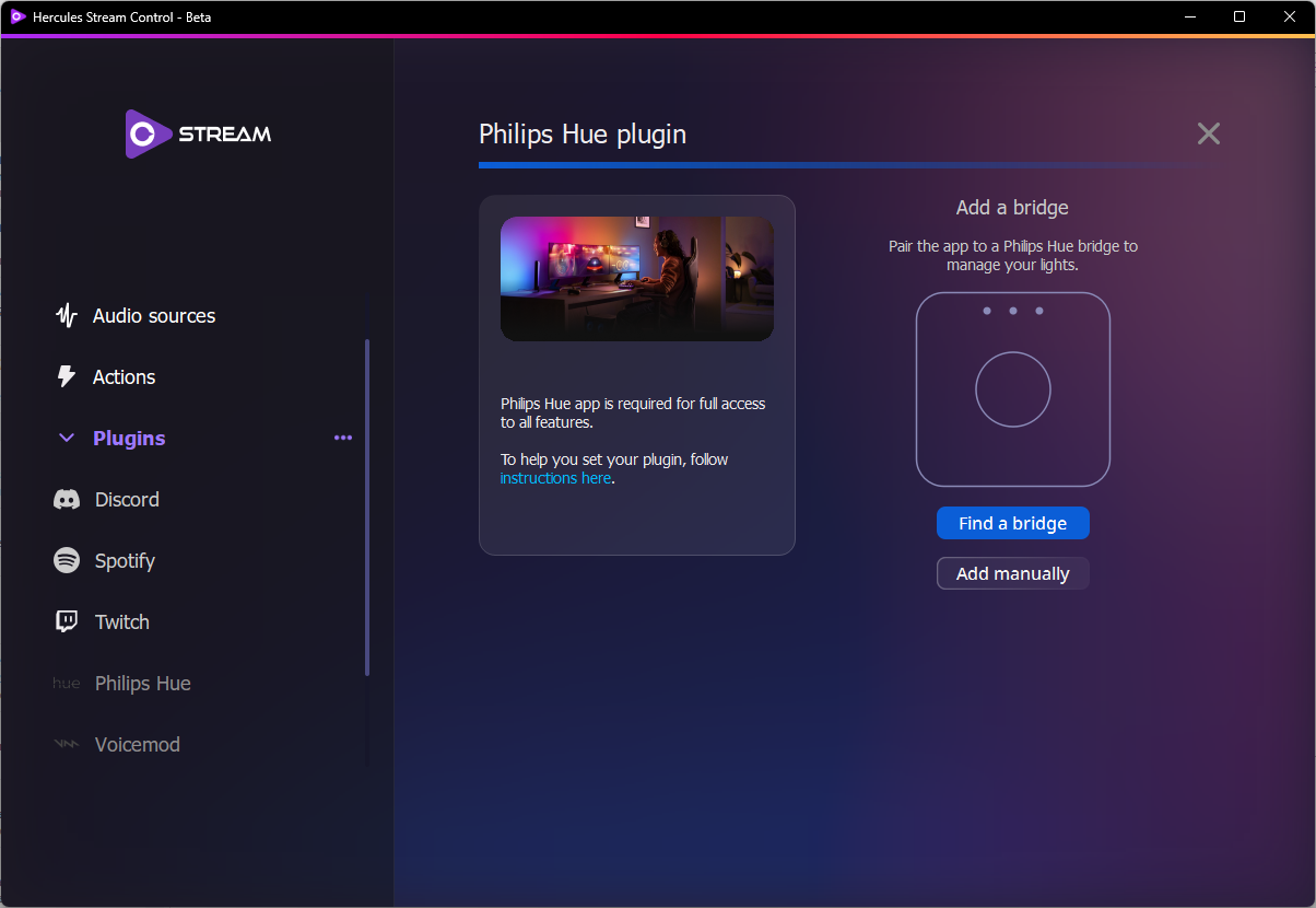

Step 1 : On the Philips Hue settings page, you have 2 options: « Find a bridge » or « Add manually »

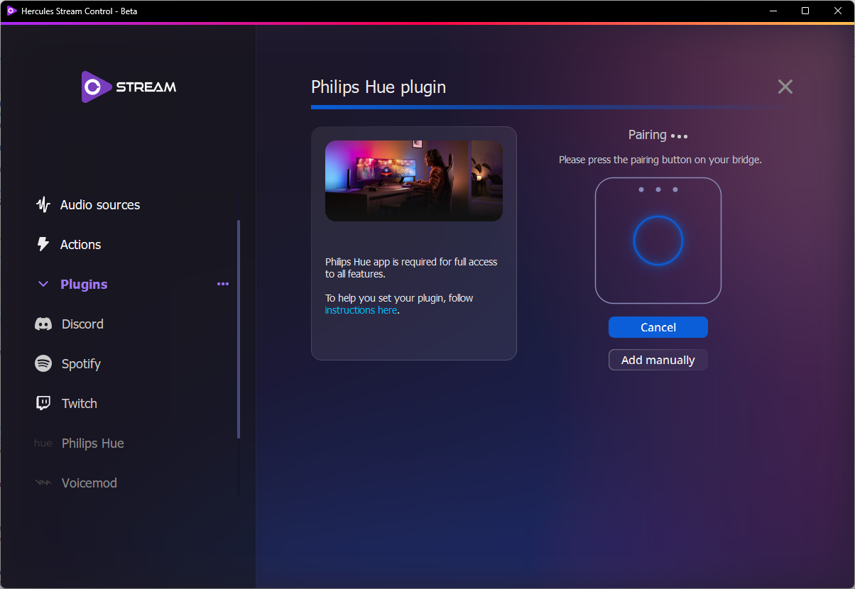

Step 2 : If you click « Find a bridge », wait for Stream Control to detect every bridge connected to the same local network. Then press the pairing button on your bridge to pair it.

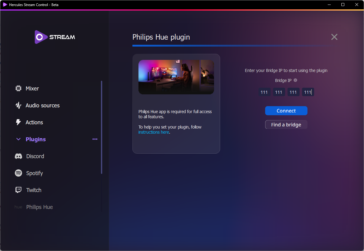

Step 3 : If you click « Add manually », type your Bridge IP to target the right bridge, then click « Connect ». To find your bridge IP, you can go on https://discovery.meethue.com/ and retrieve the “internalipaddress”.
Here again, you have to press the pairing button on your bridge.

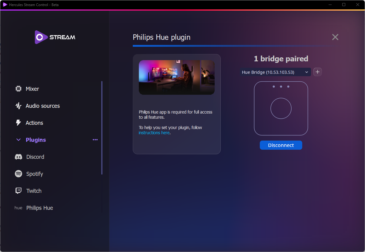

Step 4 : You are connected once your bridge appears in the list. From this page, you can Disconnect your bridge or pair another one with the « + » button.
